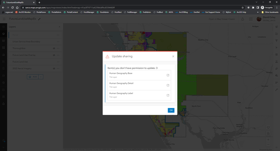

For the issues regarding the permissions error about living atlas basemap layers upon a map save in map viewer, that is still occuring:
It doesn't seem, so far, to have an adverse affect on apps, but I can't be sure until there is time for more testing.

After some time in reviewing my maps, layers and various share settings, it appears that the 'Update Sharing' dialog will appear anytime something in the map is not shared at the same level or with the same org groups as the map itself.
It's fine - it's just that this is a new behavior I did not see described anywhere in any of the 'What's New' blog articles and so was unexpected (for me anyway).
As far as Living Atlas content:  the permission update dialog warning is only occurring with publicly shared maps.  When the map is owner only, owner- group, or org-only, this warning does not appear.

That message about not having permissions to update sharing does not mean that it isn't public - it just means you don't own it and can't change sharing. I'll get an ENH in to get that message to make more sense.

Yes, I agree with you here:
"That message about not having permissions to update sharing does not mean that it isn't public - it just means you don't own it and can't change sharing."
which is what I thought as well because they are (continue to be, have always been, etc) public. And that is OK, and thanks for the ENH request...
