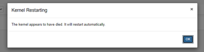

Hi guys!
In executing an ArcGIS Notebook Runtime Advanced we always getting the error message: "The kernel appears to have died. It will restart automatically." when we want to "from arcgis.gis import GIS".
It is confusing because when we try it with an Standard Runtime, it works properly. But in our case we need both python packages. arcgis and arcpy. The "import arcpy" command works properly in the Advanced Image.
Here are the details:
System: ArcGIS Enterprise 10.9 with ArcGIS Notebook Server 10.9 on a RedHat 7 VM
What we have done in reverse engineering:
1. We connected to the container directly and execute the command (from arcgis.gis import GIS)
It's working. So we conclude from this there is no problem with container or the virtual machine.
2. We analyzed the log files of the WebSocket Connection, the container logs. There is only logged "The kernel has restarted". We find no entry - why the kernel has restarted...
3. We contacted Esri Support. Unfortunately they can't reproduce it.
And the most confusing matter is that all import commands are fine with Advanced and Standard Image 4.0 It occurs with Advanced Image 5.0. From here we need python 3.7.9 package for our use case.
Perhaps I'll find some further help here. Thank's for reading my issue.

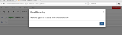

Could you please also verify what tensorflow library is installed in your environement?
!conda list | grep tensorflow
In our 10.9.1 notebook environement without CPU's AVX support and 2.5.x tensorflow  there is unfrotunately no difference in order of those two imports, both returns "The Kernel appears to have died" 😞

Hello @MaxBöcke
In  our case Esri support confirmed that notebook docker container with tensorflow 1.5 (and higher) should be run on machine with CPU that supports AVX. Because recent versions of  ArGIS Notebook runtime docker images contain such  tensorflow modules, there is a now request for documentation to be appropriately updated.
Best regards
Martin

You can try to check if your notebook's CPU supports AVX instructions by runnig following  notebook command
!more /proc/cpuinfo | grep flags
If there is avx mentioned, then you can try workarround that was described earlier by Max ( import arcpy or import tensorflow first)
If there is not avx mentioned, then you are very likely in situation similar to ours.
Our customer with 10.9.1 ArcGIS Notebook because of this temporarily uses older notebook runtimes (4.0 and 5.0) that are based on older non problematic runtime docker images where
lack of avx support does not seem to be a problem.
Regards
