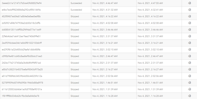

I have a notebook script which runs fine manually, and runs okay on a scheduled Task most of the time. But a few times now the the Task will go off at its scheduled time and then get stuck 'Executing' perpetually. This causes each subsequent scheduled execution to get 'Skipped' (see attached screenshot). This doesn't ever seem to resolve on its own. I've let it go on for a few days to see what would happen, but it never resolves.

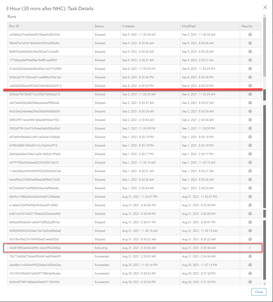

@Anonymous Userbit of an update on this -- it seems the Executing issue can still last beyond 24 hours. Included a screenshot below though not sure how legible it will be -- but the task got stuck executing on August 31, and I paused it after noticing it was skipping on Sept 2. On September 8, I reactivated the same task and the Execution problem persisted, skipping every task after. I'll recreate the task to fix it for now -- but I think the troublesome part here is that we have no way of being notified when this issue occurs. I have notification emails setup within the script notifying me when it runs into an error, and set up some logging as Tim suggested in this thread, but unfortunately the Executing issue prevents the script from running at all once it gets stuck.

Task was paused on Sept 2 and reactivated on Sept 8Task was paused on Sept 2 and reactivated on Sept 8
