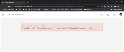

I recently upgraded our ArcGIS Enterprise platform from 10.8.1 to 10.9. Everything went smooth. All of the components are working fine, but I am not able to open or create any notebooks.
When I try to create new notebook, I get error as below
Error opening notebook. Container 0b2a4111cef23cbfa5c6d1ef87e3882747e17aac1d0ee2c03b84a6346bf95a6a is not running.
