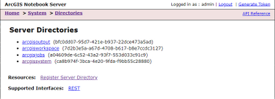

Server directories listed in Admin API as below.
