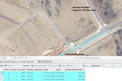

@MelindaMorangThank you for this. We have been working through the steps you provided using the calculate locations tool. When we use a broad search tolerance, like the default, it ensures all points are located regardless of being on a restricted segment. It locates them based on the nearest routable segment as expected, however, we do not get a status flag of 7 we get 0. If we use a more restrictive tolerance more appropriate to the distance between point and segment, we only get status flags of 0 or 1, this however will give us a lot of 1 flags to go through, which is not feasible as we are searching through many points. There has been no configuration that we have seen that gives us a status flag of 7, which would be a more useful flag for us. The image below shows the result of the calculate locations tool with a broad tolerance. These 3 points are on a restricted segment, so they locate to the nearest routable segment, but we get a flag of 0.
MelindaMorang
Okay, I understand the problem, and I can reproduce it on my end.  It seems like a bug in the Calculate Locations tool that the Status field is coming back as 0 instead of 7 for those points.  I will log the issue, and we'll see about fixing it.
