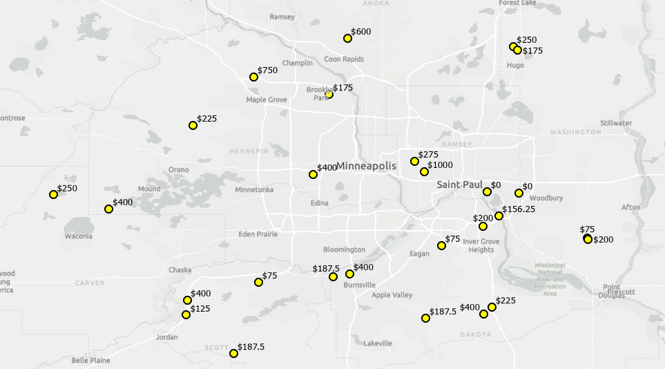

I'm not sure what the best tool is to solve this issue.  We have many dump sites around the metro area with different dump prices.
How would I make polygons around the sites that indicate the cheapest location to go to?

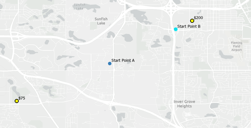

Here are two example starting points that would need to fall within a sites polygon.
Lets say it costs the driver $25 per mile to drive around. If the driver is equally far away from two sites (Starting Point A), the 75$ site would be a better choice. Starting Point A should fall within the $75 sites service area polygon. Starting point B should fall within the $200 drive time due to the short travel cost.

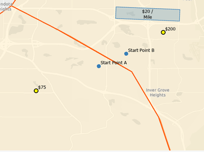

Thanks for your input. I'm trying to make service area polygons for all of the dump sites. The polygons should fill up the entire metro area with no overlaps.  The size of each polygon will depend on the Dump fee and the price per mile.
Here is the example -  Dump Site X costs $75 to use and Dump Site Y costs $200. The Starting Point B is 10 Miles from Dump Site X and 2 Miles from Dump Site Y

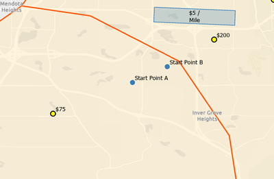

If the Travel Cost were $5 Per Mile:
The cost to go to Dump Site X would be $75 + ($5 *10) = $125 (Cheapest)
The cost to go to Dump Site Y would be $200 + ($5 * 2) = $210
I would expect Starting Point B to fall in the Polygon for Dump Site X
However, if the Travel cost was $20 per mile:
The cost to go to Dump Site X would be $75 + ($20 * 10) = $275
The cost to go to Dump Site Y would be $200 + ($20 * 2) = $240 (Cheapest)
I would Expect Starting Point B to fall within the Polygon for Dump Site Y

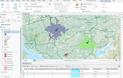

In service area, the facilities can be loaded with a "delay" in terms of the cost attribute being used to solve the service area. For example, if you want to do a 4 minute service area and a facility was set to have a 1 minute delay then it will only create a 3 minute service area. The "delay" is per facility. Here is a screen shot of three facilities with delay set to 0, 1 and 2 and the subsequent 4 minute service areas.
You need to set up a network dataset with a cost attribute set up in terms of $ per mile then you can use the delay concept to load the facilities with the trash fee at that facility and generate your polygons.
However, if you are planning to use the online service, it does not have a cost per mile attribute.
