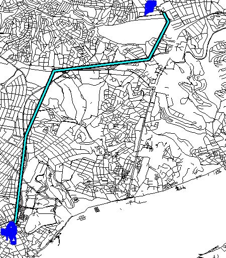

I have a toy network dataset with two types of lines: Pedestrian lines and a metro line.
I have an attribute called speed-kmh, which is 5 more pedestrian lines and 40 for the metro line. I also have another attribute which gives the length of these lines in kilometers.
When creating the network dataset I created a cost attribute called "hours" by dividing these attributes.
When I perform OD analysis on this network dataset, the calculations seem to ignore the metro line and report the hours only considering the pedestrian route.
Here is an illustration (I am sorry for the bad coloring):
- Blue line represents the metro line.
- Dark lines represent the pedestrian lines.
Normally, with the metro line, the distance between the areas in dark blue should be at most 10 minutes. However I am getting 40 minutes which would be normal as a walking time.
Do you have any thoughts on why I might be having this issue?

I can't really tell what's going on in your screenshot. I can't see whether the route is actually traveling on the metro line or if it's using only pedestrian lines.
Assuming it is not using the metro line at all, my guess is it's probably a connectivity issue. If the pedestrian lines and metro line are not connected to one another properly, the traveler will not be able to switch between them. Assuming the start and end locations are on the streets, the traveler can't get onto the metro line, so they just walk through the streets instead.

I took a quick look. I still looks like a connectivity problem to me. Your metro line does not have vertices at the locations where it intersects with the streets, so the network dataset does not allow travel between the streets and the metro line.
