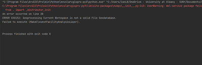

Full disclosure: I've successfully run the tutorial Paris code for the network analyst extension creating a closest to facility network once.
Upon retrying it and even starting fresh with new code and .gdb the code fails wit this error message...
I've had the same exact experience with my own personal .gdb. I was able to run the code successfully once and when I went back the  next day to run it again the code fails with the  same exact error message as above. Is there a bug with the Paris.gdb tutorial or something larger going on because I've recreated both the tutorial and my own dataset multiple times and cannot seem to get the script to run successfully anymore. Any and all ideas are appreciated as the final weeks of my semester approach.

Hello, Ian.
I suspect the issue here is that your script needs to set arcpy.env.workspace to a valid file geodatabase where the NA layer's analysis data will be placed.  You can read some explanation of why this is necessary in ArcGISPro here: https://pro.arcgis.com/en/pro-app/latest/arcpy/network-analyst/migratingfrom10xarcpynetworkanalyst.h...

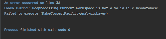

MelindaMorang
For this one, the problem is that it cannot set the environment workspace to the designated file gdb.
# Set environment settings
output_dir = "C:/Data"
# The NA layer's data will be saved to the workspace specified here
env.workspace = os.path.join(output_dir, "Output.gdb")
Does C:/Data/Output.gdb exist?  If not, this is your problem.  You must set the workspace to a geodatabase that exists.
