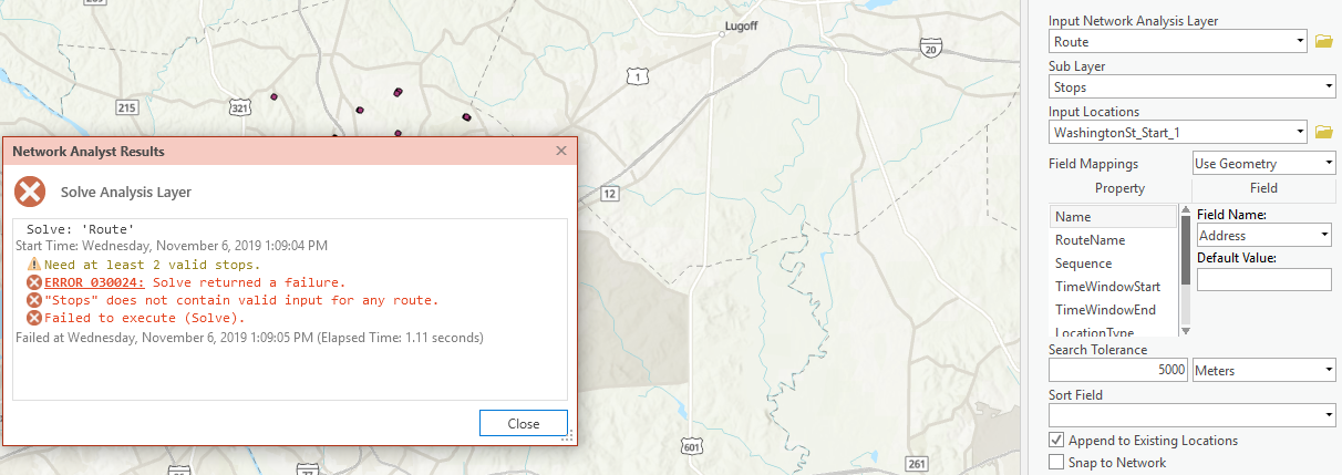

Its 57 Stops is all.  I wondered if it was just timing out due to the area but I mean why does ArcMap do it very easily and with most of the time even more stops 100's of stops at most?  Well I run the Route where it says WashingtonSt_Start_1 is the list of 57 Points to stop.  I get this message when I click Run now.  Thanks for the time

JaySandhu
The returned error message tells you exactly the problem you are having in this case. No valid stops. It is likely that either the WashingtonSt_Start_1 has less than 2 point features OR a selection that has selected only 1 point feature. In which case the route solver cannot solve the route with less than 2 stops.

BillMorgan1
I see what happen there I had the wrong file selected because of 2 that were close in names.  The real issue is that once I hit "RUN" to create the route under "find best" it just gets stuck in a loop.  The same network dataset didn't do this in ArcMap so trying to figure out what is wrong
