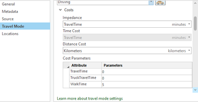

If it is using a local network dataset, check the travel mode settings and see if the distance impedance parameter is set.

Impedance is set as TravelTime (minutes) with a cost parameter of 0.
