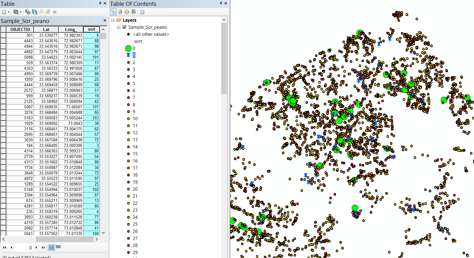

This is what I have done now.
Still getting the same results.
DanPatterson_Retired
MVP Emeritus
did you complete the equation using the sorted id's in the Sort field to get the groupings? It is hard to see from your overview map
