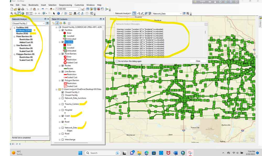

Hi, I am analyzing the closest facility using the Network Analyst tool. I wanted to find the closest hospitals for each traffic accident.
In the closes facility window, there are six classes to be specified.  I used hospital locations as Facilities and Traffic accident locations as Incidents.
I specified Length as impedance, and the direction was "Incident to Facility". I wanted to find the closest facility (hospital) for each incident (crash).

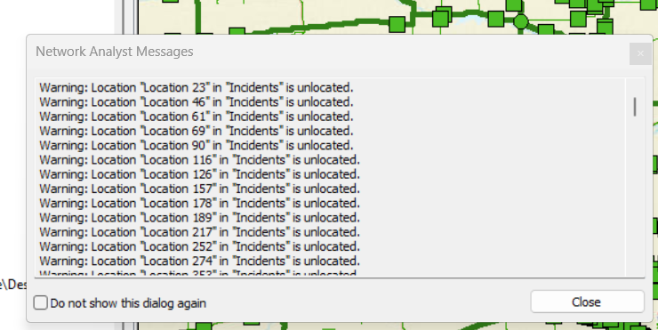

After specifying the parameters, I clicked "solve," The result only showed the closest facility for 936 incidents. But my incident was 3396.  Please note that the tolerance parameter was 5000 meters.
Can you please tell me what could be the problem?
I have checked that the incidents attribute table of incidents and found only the status of 75 incidents was unlocated. But after solving the problem, 936 incidents were solved for the closest facility.

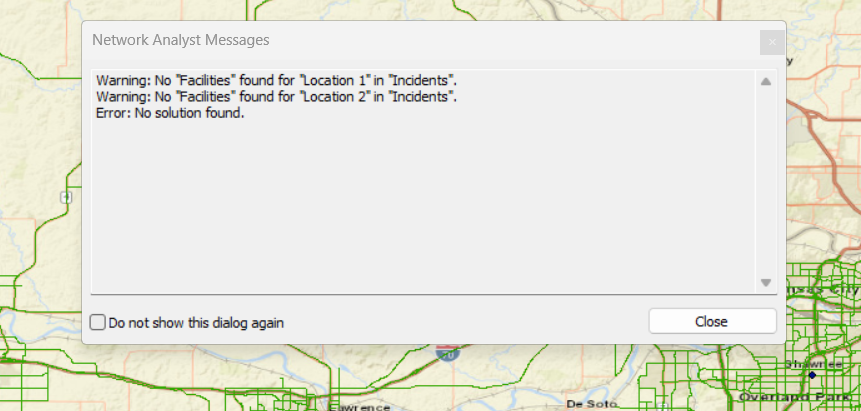

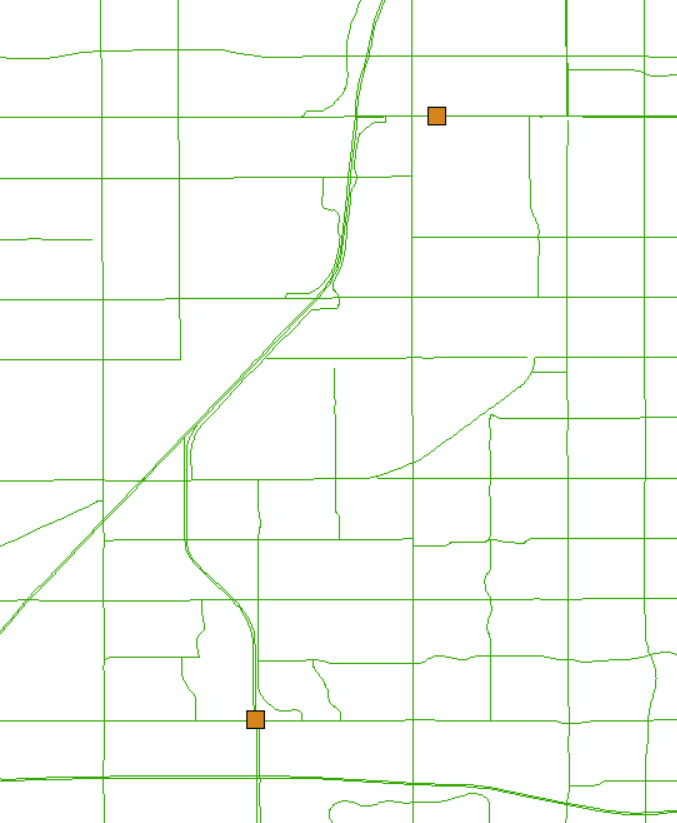

Hi @JaySandhu , thank you for your cordial response. I tried the solution mentioned in the first comment. I took two incidents that did not find facility and solved it, again and again, showed the same error (see attachment)
In your second comment, you mentioned a solution; I will try this. But there is a problem. Because, 936 incidents got facility out of 3396 incidents. That means nearly 2500 incidents did not get facility.  It is tough to individually do  new route analysis, for every missing incident ...is there a short cut way to do so?
Can you please explain the road connectivity and how it can cause a problem? I cant remember what was the road connectivity while I created the network data from the road network shapefile. But there are no oneway restrictions or other barriers...

What is the source of your data? What is the connectivity policy that you are using? For example, End Point or Any Vertex.
If your connectivity policy is End Point then every street feature connects at its end point to another street feature. If there is a gap then the roads are not connected. If your data is from Open Streetmap then you may want to set it as Any Vertex.

@JaySandhu  thank you very much. It was the problem of connectivity. I created the network dataset again with "any vertex" connectivity. The closest facility analysis now showed very good results. However, six incidents did not get the facility. What could be the reason for that? How I can troubleshoot it?
