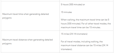

Hi all, I'm trying to create a 20-min cutoff for my service area polygons. If I try to add it in through the travel settings, I get "ERROR 030136: The largest break value, 20, exceeds the threshold, 15.000 Minutes, set to generate detailed polygons." Is there a way to change the threshold that I may create the polygons that extend past this 15-min limit?

Based on that error, I'm guessing you're using our ArcGIS Online Routing Services to create these service area polygons. When using the ArcGIS Online Routing services, there are limits to the number of inputs or size of requested output. For the Service Area Routing Service, there is a 15 min or 15 mi cutoff limit when you are requesting detailed polygons.
https://pro.arcgis.com/en/pro-app/latest/help/analysis/networks/credit-consumption-and-analysis-limi...
If you would like a larger cutoff, then you can switch to generating generalized polygons, which are gnerated quickly and are fairly accurate. Or, if you have your own local network dataset, then you can use that as the network datasource. In that case, there are not hard limits on the size or number of polygons you can generate in a single solve.
If you are not using ArcGIS Online Routing Services as your network datasource but are still getting that error, please let me know and we can dig into this further 🙂
