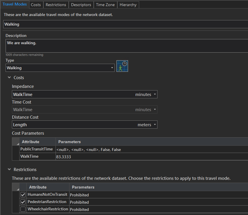

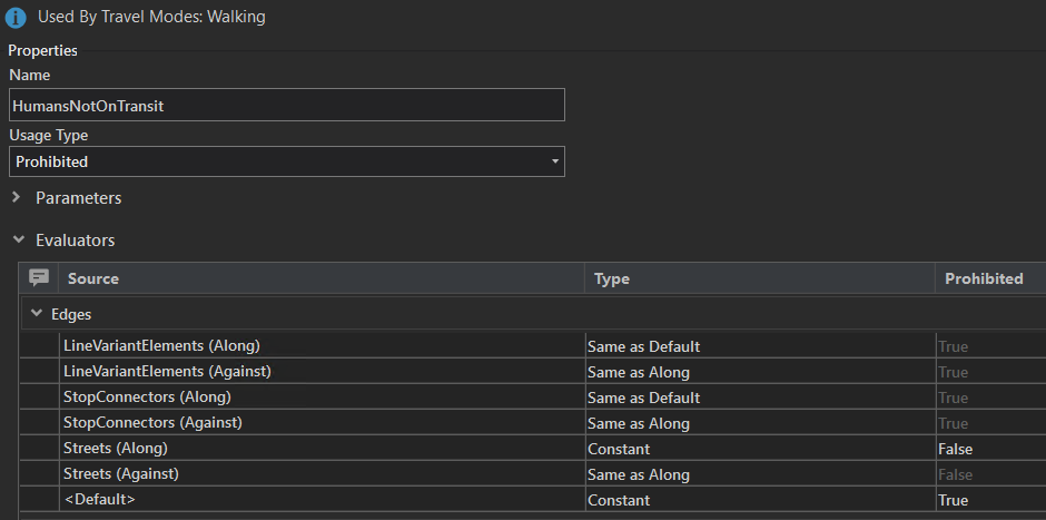

I caught the warning about public transit travel time mode, and created some new restrictions alongside a new travel mode that should only use WalkTime as impedance and restricts access to StopConnectors and LineVariantElements. I've attached some screenshots of this new travel mode and the corresponding new restriction.
This is what I've been using with my calculations so far. Do let me know if I require another Network Dataset and I'll see to making that work!New restrictor - HumanNotOnTransitNew restrictor - HumanNotOnTransitNew travel mode - WalkingNew travel mode - Walking

A bit more troubleshooting and I realized that I must have used incorrect settings when creating the travel mode (which I must have fixed somehow before taking those screenshots (?)), because now the tool is successfully getting past the "Solving Service Area Analysis..." step.

Hmm, using the transit-enabled network for walking only with restrictions like you're using or other ways to prevent using the transit lines is generally okay.  For a route or OD cost matrix, it would work fine and produce the right results.  However, for Service Area specifically, I think polygons it will generate will be kind of nonsensical.
The Service Area solver runs an algorithm to generate the polygon geometry, and this algorithm has a lot of rules around when to cover or not cover edges in the network.  Let's say you have an ordinary city block, and all streets surrounding that block were reachable within the travel time limit.  Then the entire area of that city block will be covered by the polygon.  Let's say only three of the four sides were reachable.  The polygon generation algorithm does some math and covers only part of the interior of that block.  Let's say all four sides were reachable, but a small dead end going into the center of that block is NOT reachable or is restricted.  More math happens, and the polygon geometry will have a hole in it to account for the unreachable street.
The problem is if you have a bunch of transit lines criss-crossing your network that are restricted or effectively unreachable in the analysis, the Service Area polygon generation algorithm will go to heroic lengths to avoid covering them, sometimes producing really weird and complicated geometries that really aren't what you want.
For your case, I think it would be better to create a separate network.  You can make a copy of your current network and remove the LineVariantElements, StopConnectors, Stops, and StopsOnStreets (and then delete the feature classes and all the associated transit tables).  Or you could start over from scratch with your OSM streets.
