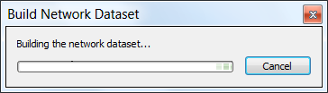

I created a network dataset and let it build straight after creating it. It has been building for over 5 days now - I can still see the "progress bar":

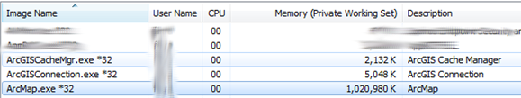

The machine I am building it on has plenty of memory and CPUs so it cannot be due to lack of resources. There seems to be nothing going on when I look into task manager. CPU is at 0%, plenty of free memory.
What should I do? Is it possible that the network has been built but ArcMap didn't receive the right signal? Is it going to corrupt my file geodatabase if I kill ArcMap from task manager?

I have seen in the past in Arc where a process apparently doesn't complete but it actually has.
If there is nothing going on in Task manager I would kill the application, then have a look.

In short, I killed ArcGIS using Task Manager. The network was not built so I could not run any analysis.
