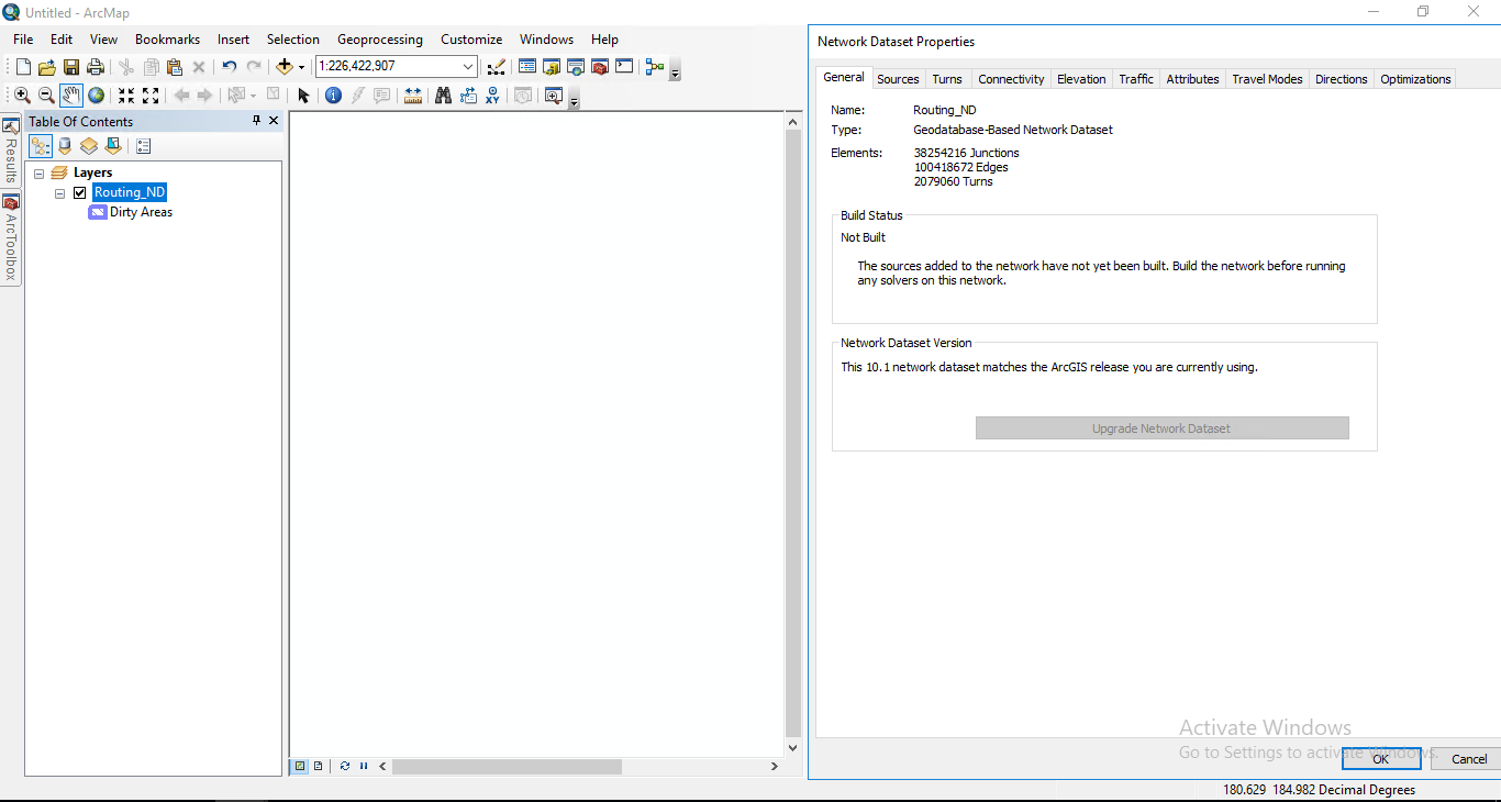

LeoDeng
Hi Jay,
This is the SS from the network dataset properties and the dirty area layer.
There is no dirty area on the map.
Is there any way to repairing the date/time stamp that makes the built status correct?
Thank you!
Leo
