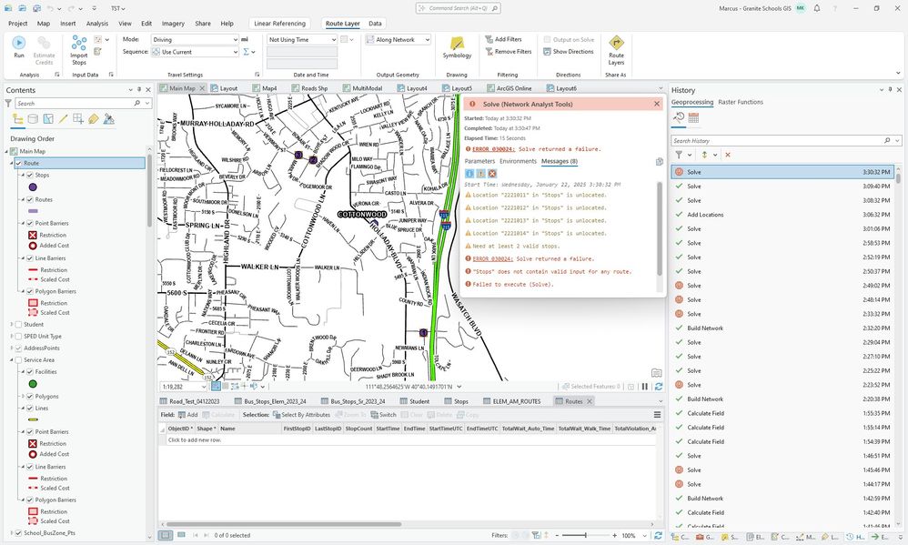

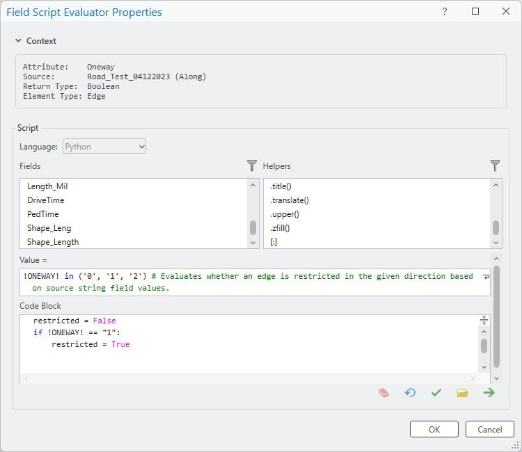

@MelindaMorang I recently installed ArcGIS Pro 3.4, and started to updated the network dataset I download from the local government GIS site.  Then, I created a travel mode for buses and attempted to create a "Oneway" restriction.  The attribute field uses numbers in place of text (0 = Two-Way), 1= FT, and 2=TF).  Upon opening the Field Script Evaluator Properties window, two things pop out.  First, the parcer only accepts Python instead of VBScript, and second of "Result" you now have "Value" which is rather confusing to me.  So I do my best to convert the code to Python.  But, after assigning the restriction, building the network and running the route builder, I get an error message, saying my stops are unlocated and cannot be map.  When I uncheck the "Oneway" restrictor, the route is created, though not as I like.  Any asistance would be appreciated.
