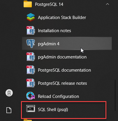

You can use the SQL Shell (psql) that comes with the Postgres installation. You can find it by opening the Start Menu and expanding the PostgreSQL folder on the machine where PostgreSQL is installed.

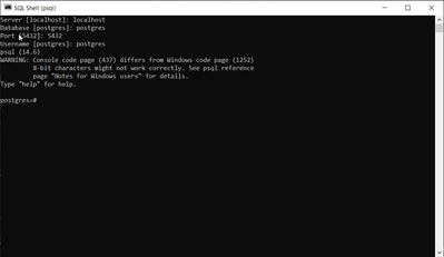

Once you open the SQL Shell, you'll be prompted to connect to the default Postgres database. Personally, I enter the values in the bracket, my install is default:
After, you can paste the script into the SQL Shell after making your edits, and it should run; you may have to hit enter on the "GRANT ALL" command to complete the script.

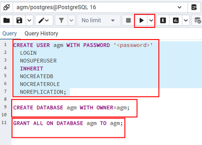

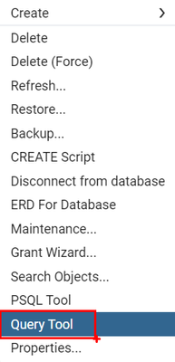

I prefer a GUI interface and like to use pgAdmin 4 for this process.
Once logged in as a DB Admin user, 'postegres' by default you can right click on your default 'postgres' DB and choose Query Tool > Then Copy Paste the SQL commands from the AGM Help > fill in a password and run each block separately by highlighting and choosing 'Execute script'.
