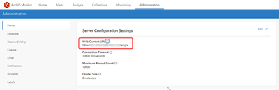

Yes, it should work. After enabling the IIS rewrite rule, did you modify Monitor's Web Context URL?
If not, this may be playing a part in the issue you're seeing. Try modifying the Web Context URL to reflect the rewrite rule, restart Monitor, and see if the issue persists.
