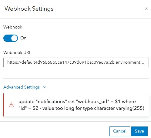

I am trying to update my webhook settings for my Power Automate flow. I got a notification that the URL in Power Automate has changed and need to update.
When I go to update it in the Notifications > Webhook Settings, I get this error.
update "notifications" set "webhook_url" = $1 where "id" = $2 - value too long for type character varying(255)
Any ideas on what I need to do?
Thanks!

How long is the new URL (number of characters)?  Could it be longer than 255 characters?
AndrewThompson_SCE
Yes, it is actually. How would I be able to shorten it? Would that maybe fix it?

For organization webhooks (ie webhooks created in Portal), we have an issue logged and will attempt to fix it in the 12.1 release of Enterprise. The problem, as identified, the URL length has become longer than the database field allows for the URL value. It seems like Monitor has the same problem.
BUG-000179555 - When attempting to register an organization webhook in ArcGIS Enterprise using a Power Automate Request connector's "When an HTTP request is received" trigger URL, the operation fails with a database error.
