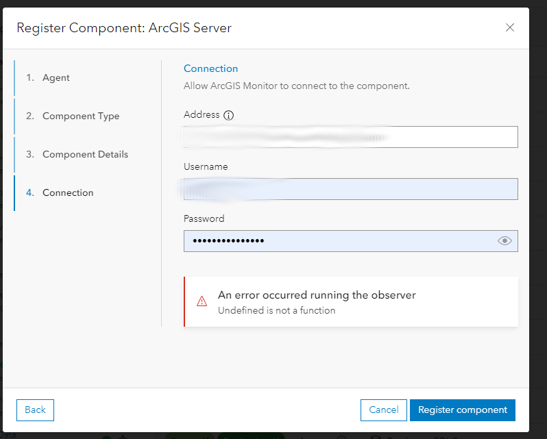

I recently upgraded Monitor server to 2023.3.1, and since then I've been getting alerts for "Connectivity - arcgis_server_discover (%)" for our federated servers. If I try to reconnect, I get the error "Undefined is not a function." See screenshot below. I don't see anything in the logs for Portal or either of the affected servers. I also upgraded Enterprise from 11.0 to 11.1 a few days later, but that did not seem to improve the situation.
Has anyone else encountered this, or have any thoughts on how to proceed?

Hi @JCGuarneri,
Can you please review the workaround described in this post, Monitor broken after 2023.3.1 install?
I believe the solution provided by Josh should address the issue.

JCGuarneri
Ah, thank you! That did the trick. I was able to reconnect via settings immediately. However, it did not show any updated metrics until I restarted the Monitor service. Hopefully that's it for now.
