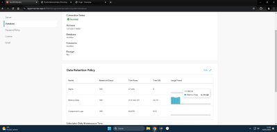

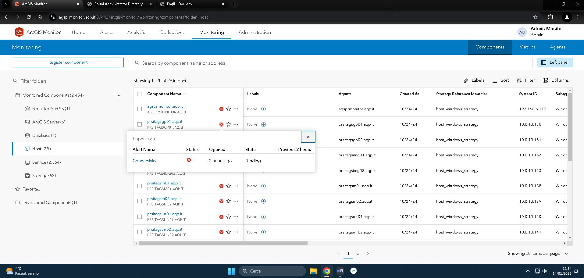

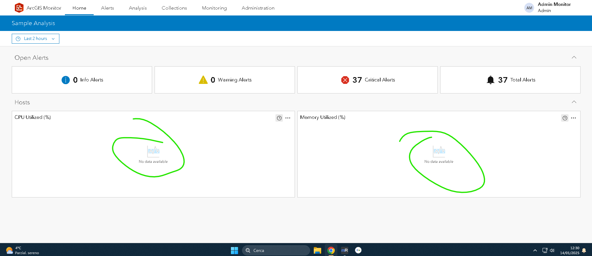

from the ArcGIS Monitor home page I note no data available

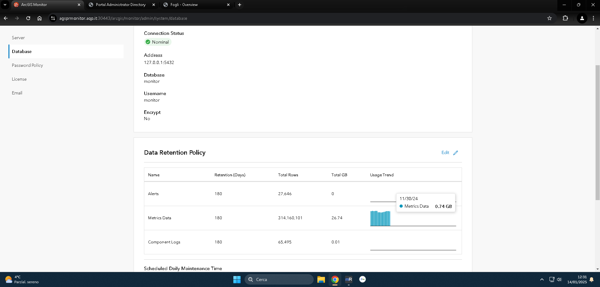

So I checked how long it has been stopped, and I found out from the Retention Policy screen that it has been stopped since 11/30/24.
The DB shows no problems fortunately
In the Monitoring and Host section I find all the VMs in Critical and Connectivity anomaly (found 2 hours because I performed a server reboot to see if it resumed normal operation)

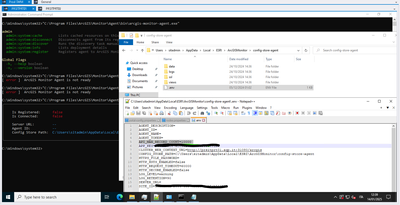

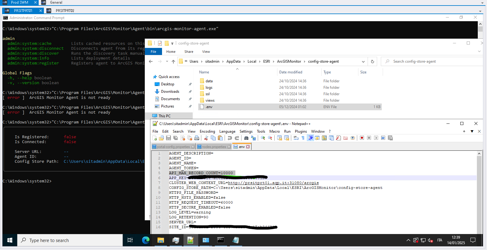

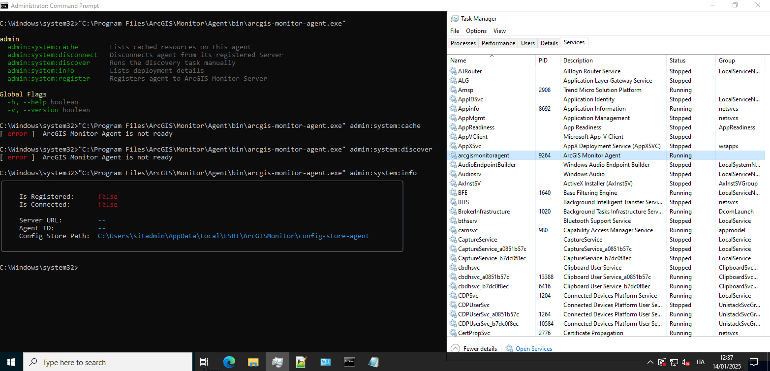

I went to check a host out of curiosity and ran some commands, it seems the agent has disconnected from the server.
I also checked the .env file in the config store folder, everything seems ok
on a VM I upgraded the agent, but unfortunately it did not reconnect.

ps: if I re-register, the server tells me it is already registered

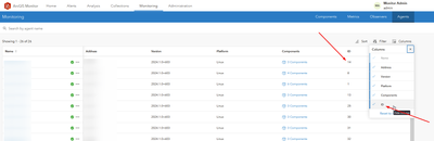

Hi @VirgilioPalmi, when you are re-registering the agent, are you including the --agent-id flag? If the agent is already present in ArcGIS Monitor Server, then you need to include this flag, followed by the ID of the agent in question. You can find the agent ID by going to ArcGIS Monitor Server > Monitoring > Agents, and enabling the ID column:
To re-register the agent, the command should look like this:
./arcgis-monitor-agent.exe admin:system:register --server-url https://agmserver:30443/arcgis --username admin --password MyPassword!1 --agent-id 2

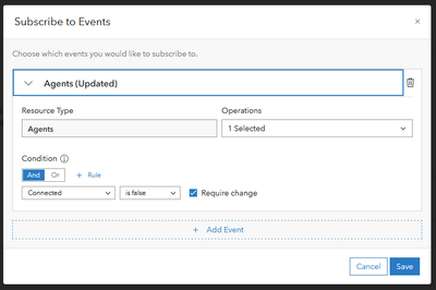

  • You can configure an alert in ArcGIS Monitor Server to let you know when an agent becomes disconnected. While not a solution to the problem, it would minimize the time that data is not being collected:
Josh
