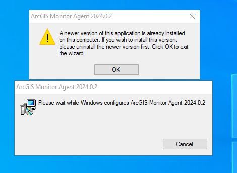

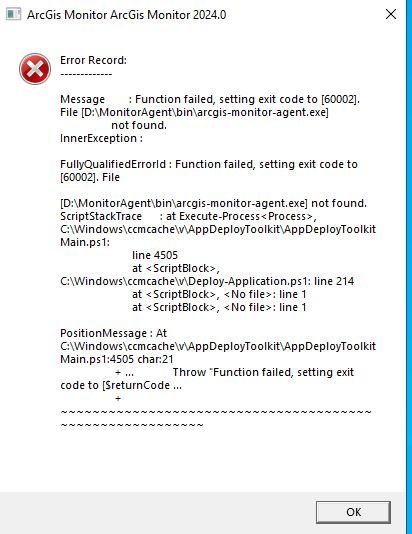

After upgrading an agent to 2024.1.1 The following errors pop up anytime someone logs on to that machine.  I've attempted to unregister the agent, uninstall and reinstall with no success.

I manually ran the 2024.1.1 installer over the existing 2024.1.0 install and did not experience your issue.
From the screenshots, it appears that this is a Windows Installer issue where the SCCM task didn't completely unregister the app and there are some orphaned registry entries.
With 15 year of app deployment experience, I can say this is where I end up going to the old Microsoft "Windows Installer Cleanup" utility which can be found out there in download archives (since Microsoft no longer supports it) and removing the orphaned app install registration through that tool.
Try manually installing the new agent on another server next time without a deployment tool and verify you don't get this behavior, and then you'll know if this is an Esri issue or your deployment tool is at fault.
