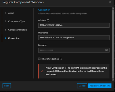

Hi @AlexBakhtin and @naveenbesri,
During registration, can you please try putting the address of the Windows host before the username like in the screenshot below? Let me know if this makes a difference.
Thanks,
Josh
AlexBakhtin
We get the same WinRM error as before, looks like it is slightly different than the topic's error though:

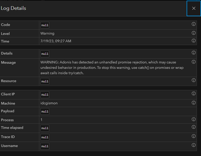

We also see these errors show up in Administration --> Logs. Not sure if it is related to us trying to register this component or not related at all:
Alex Bakhtin
