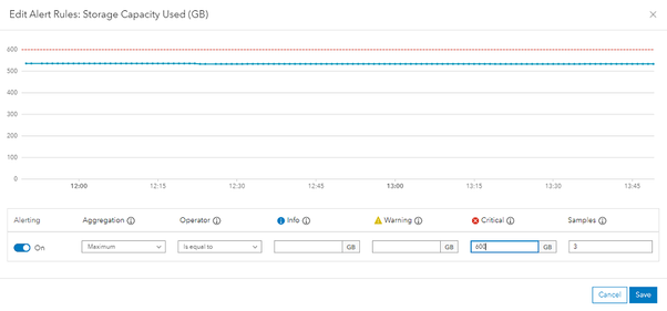

Please try this workflow:
1. Login into ArcGIS Monitor > Monitoring tab
2. Under the Filter folders - select Storage
3. Select the storage device you want to set an alert on - this will display the overview metrics page for the storage device
4. Select the Metrics tab (in the upper right banner) - this will display the different properties of the storage device
5. Click the ellipsis button (the three dots) for the parameter you want to set the alert on, for example "Storage Capacity Used (GB)" > Edit alert rules
6. The Edit Alert Rules dialog should appear for the selected parameter and you should be able to set an alert
Hope this helps,

@DerekLaw Thanks for getting back to me so fast.
This give me the ability to set the alert to a set #GB, our disk drive sizes vary on our 50 servers

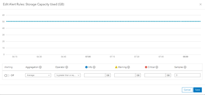

ArcGIS Monitor 10.8.1 Allows the following:
We set our alerts Warning at >75% and Critical >90%, this way I don't have to figure out these percentages and stay appropriate as we add or remove disk space.
