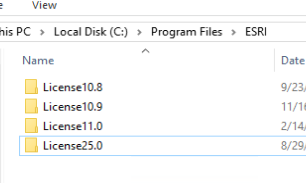

Navigate to the (C:\Program Files\ESRI) on the ArcGIS Monitor 2025.0 server. The license file is not created under the License25.0 folder, but rather under the old License24.0 folder. Renaming that folder to License25.0 fixed it, and AGM 2025.0 will now find the license file.
It should look like this (C:\Program Files\ESRI\License25.0)
