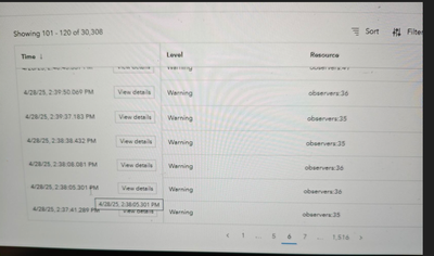

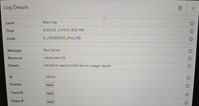

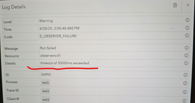

NicolasNi1977
Hi @DerekLaw
- Which release of Monitor did you upgrade from? - We upgraded from ArcGIS Monitor 2023.1 to 2024.1.0 then to 2024.1.1
- Were metrics being reported for the feature services before the upgrade? - Yes
- Is this for all registered ArcGIS Server sites with Monitor, or just some of them? - We only have one ArcGIS Server Site.
- What release of ArcGIS Server is showing this behavior? - ArcGIS Enterprise 11.3, it was upgraded from 10.9.1 not long ago.
- Can you provide some screenshots or error messages? - Refer to below
NicolasNi1977_0-1745895771439.pngNicolasNi1977_1-1745895832750.pngNicolasNi1977_2-1745895885874.png
