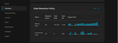

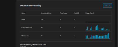

I upgraded our ArcGIS Monitor to 2023.3 and now the database data is not showing correctly. There is a new Alerts section in the database and that seems to be breaking the database links to Monitor.
ArcGIS Monitor 2023.2
ArcGIS Monitor 2023.3
After the upgrade I am not getting any metric data showing in any serial chart. It looks like the database is not accepting any new information.

Hi @Pat_Gallagher ,
I believe the issue you are encountering is a bug which prevents the schedule DB maintenance task from running, and new partitions are not created. This will be addressed in a 2023.3.1 patch we're compiling. As a workaround, running this manually via Admin > Database > Run should alleviate the issue and metrics data should begin to appear. If not, please reach out to support and we can diagnose further.
