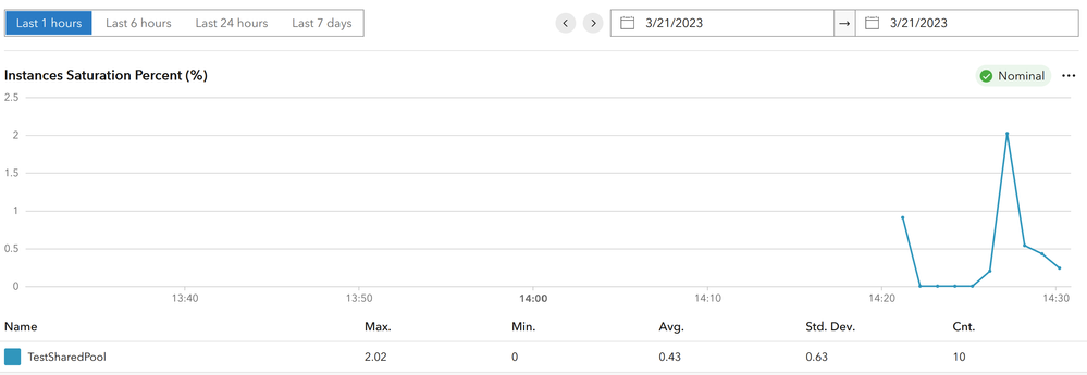

Yeah that definitely looks like the issue. I created a new service and configured it to the shared pool in the Share Web Layer pane in Pro and that graph looks like what I would expect:

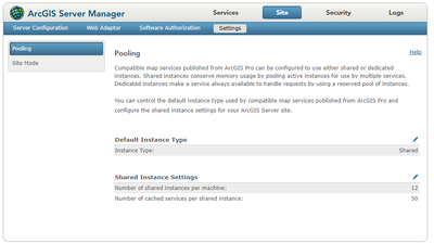

I'm curious what ArcGIS Server's "Number of shared instances per machine" setting is currently set to. You can check this by signing into ArcGIS Server Manager > Site > Settings.
The default is 4 and when I query a service that is set to "Shared", the "Instances Saturation Percentage" metric in Monitor reflects between 15% and 30% which is what I would expect. If you are seeing that this metric is spiking to 100% every time a service is queried, this may be a sign that it should be increased.

Our shared instances is set to 8, and we just have a single machine site. Maybe I'm just coincidentally viewing it when all instances are handling active requests (which may include other services in the pool)

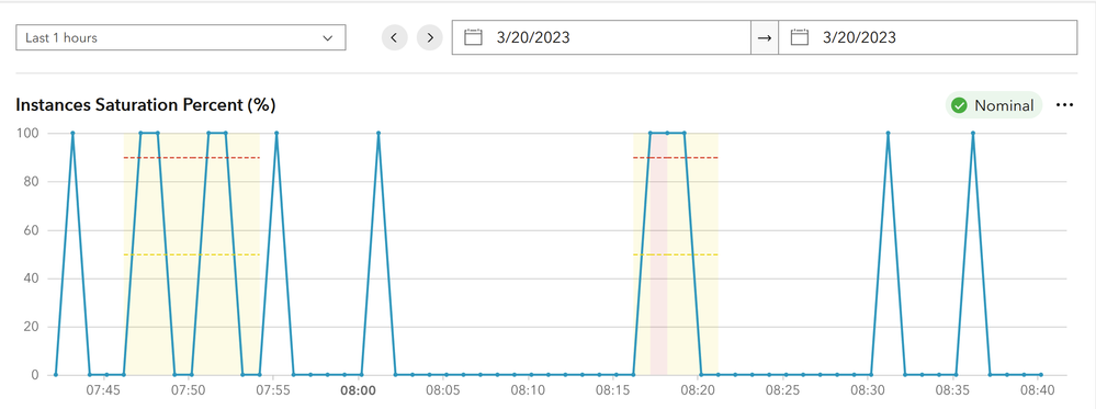

This is what the graph looks like for a service that's in the shared pool:
As you can see it's always bouncing from 0% to 100%

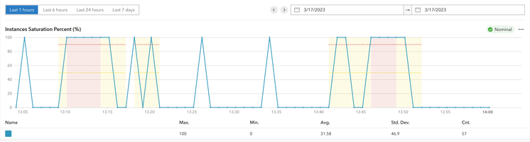

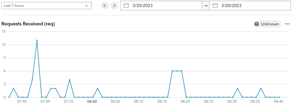

For example the two charts below are for a single service in the shared pool. You can see the smaller spikes around 7:50, 8:00, 8:30, 8:35 all were where 2 requests were received, yet the instance saturation at the same time was 100%.
Basically I never see a saturation percent at any value other than 0 or 100 on a service in the shared pool.

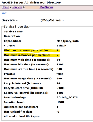

I can't help myself, so I continued to dig. Some of the services I switched to shared show 0 for both the Min and Max instances per machine when you look at their properties in the server admin directory. These are the ones that bounce between 0 and 100. So to test, I edited the min/max instance for one of my shared pool services to 1/2 and now it's reporting properly in Monitor.
For whatever reason those get set to 0 sometimes when moving to a shared instance and I think that causes issues in how Monitor reports the instance saturation. Changing these values in the admin dir is probably not a supported workflow but if it's part of the shared pool I don't think these numbers matter. I also have a ticket open with support to see what they say.
