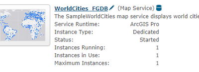

Note, the instances used and saturation reported by ArcGIS Monitor are approximation of Instances in Use, not Instances Running (which is measured by arcsoc.exe process), see below:

  • Instance Saturation Percent and Instances Used Avg are tightly related and reflect in use instances:
            Instance Saturation Percent=Instances Used Avg/Instance Max*100
       Arcsoc.exe CPU (but not count) reflects instances in use, and therefore should correlate with the  Instance Saturation Percent and Instances Used Avg
  • arcsoc.exe process count reflects instances running.  Note, you can technically have all instances running idle, in your case 15, with 0 load, see my explanation above.
  • Let's analyze the last reading in your screenshot
Instance Saturation Percent=0.45/15*100=3.3%
