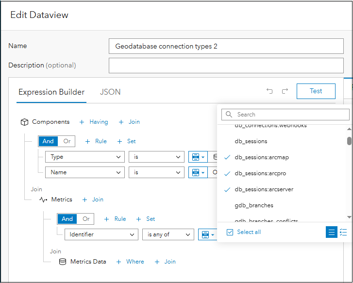

I've configured a serial chart to show the number of geodatabase connections, separated out by connection type,
This is the dataview expression to generate this,
And the configuration settings for the serial chart element,

Okay, I learned something new from your post. It looks like for Oracle-based databases and geodatabases, ArcGIS Monitor reports some additional metrics, including the ones you asked about. These are not reported back from SQL Server and PostgreSQL; which is why the metrics you asked about were not documented.
I want to create a view that shows current Oracle SDE sessions broken out by client type (Arcmap, Pro, and Server).
I have also attached the exported JSON file for the sample analysis view, so you can easily import it into your ArcGIS Monitor instance, but you will have to edit the dataview expression (because mine uses component name).
