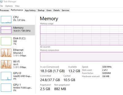

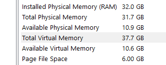

AndrewSakowicz
@TimoT . Thanks for reaching out.  At this point, I don't think this is a bug with ArcGIS Monitor, but more likely the actual vm memory spikes in your environment or how the System Managed allocates extra pages.    For example, see the following known issues
 https://pro.arcgis.com/en/pro-app/latest/tool-reference/appendices/windows-page-file-management.htm
https://learn.microsoft.com/en-us/troubleshoot/windows-client/performance/slow-page-file-growth-memo...
We can verify if it by reviewing the following information for a specific time.
  • ArcGIS Monitor PageFile Utilized (%) metric screenshot
  • System Information
  • Taks Manager
  • Powershell (that's what ArcGIS Monitor uses)
Get-CimInstance -class Win32_OperatingSystem | Select-Object Caption, LastBootUpTime, CurrentTimeZone, TotalVisibleMemorySize, TotalVirtualMemorySize
Get-CimInstance Win32_PageFileUsage| Select-Object CurrentUsage
  • Logs
If this is arcgis server or portal machine, check logs for vm errors.  Also, anything in the event viewer?
TimoT
Thanks @AndrewSakowicz.
This is a Notebook Server machine. Memory usage on this VM looks to be very stable with under 50% system commit charge.
System Information shows Total Virtual Memory as expected (Available Physical Memory + Page file space). Page file space was 4.9GB, available virtual memory was 17.9GB (shouldn't this mean 27% page file utilization instead of 85% being reported in Monitor?). No memory errors found in logs or event viewer. The powershell commands report numbers in bytes that look close to what is reported in System Information.
I've since restarted this VM and the alert has gone away (it had been active for a few days). A couple of differences I'm seeing post-restart:
  • System Information Page File space still showing ~4.75GB, but available virtual memory is 23.6GB. The disk volume pre-restart and post-restart both report 145/149GB free space
  • The below powershell command shows Current Usage at 0
I'll continue to keep an eye on the machine and ArcGIS Monitor.
Thank you
AndrewSakowicz
Note, page file utilization is in reference to page file, not total virtual memory and is calculated as:
Get-CimInstance Win32_PageFileUsage| Select-Object CurrentUsage / Page File size *100
So based on your original statement, "Currently, the pagefile is using approximately 4.5 - 5GB" and "System Information Page File space still showing ~4.75GB" 4.5/4.75*100=94%
