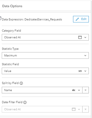

Hi Daniel, this is what I have come up with as far as an expression. As part of my selection, I did have to go through and specify the removal of the System / Utility folder services.
This is my element configuration as well

@ReeseFacendini  this is exactly what I needed, thank you so much for taking the time!!
