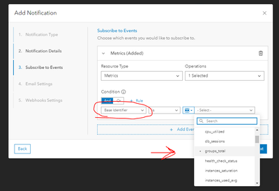

Hi @Clint_Lusk,
Thank you for the extra details. There's not a very straightforward way of accomplishing this right now. The closest I can think of is to follow the steps I outlined above but instead of using the "is" operator, use the "is any of" operator and select all the relevant metric IDs. For example:
I understand this may be cumbersome as it requires you to first make a list of all the relevant metric IDs. I will make this use case known to the development team and see if we can improve on it in a future release.

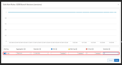

Follow the steps below to configure a notification on the "GDB Branch Version" metric.
1. Set the alert rules as you see fit. Make sure alerting is enabled.

Hi @Clint_Lusk,
