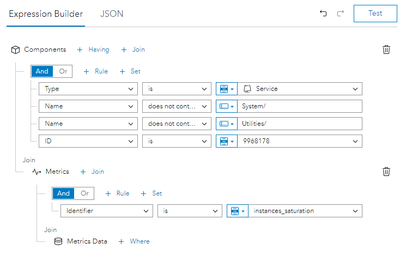

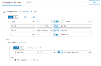

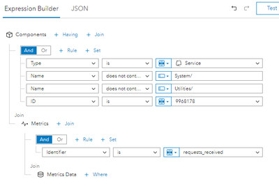

Greetings, I would like to see the "request_response_time_avg", and "requests_received" , "instance_saturation" for all my raster layers in one Analysis. What is, or is there, an expression that will allow me to do this.  It is clear that the "And" potion of the expression does not work (obviously) for multiple ID's.

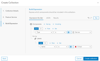

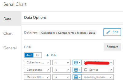

There are several ways to accomplish this, e.g. create custom a dataview or as follows (2024.01):
1. create a collection with labeled services, e.g.
2. Create chart using the following system data view and the expression referencing the above collection, e.g.
