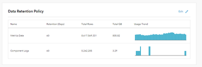

My PostgreSQL directory has grown to 810 GB and I would like to reduce the size of this.  I have adjusted my reporting frequency to help this in the future.
Is there a way to reduce the size of this database and keep my historical data?

The best way to reduce the size of the database is to configure the database retention policy to delete data more frequently than 180 days (60 to 90 days perhaps).
SteveMcCarthy
So this will remove the data older then the retention policy?  How long does that take?
I changed it from 180 to 60 days,

The database maintenance schedule is when it will run and clear out the items. You can click the "run now" button (below the retention policy table) to fire off that process now.
SteveMcCarthy
I don't see the run button.  I'm running version 2023.2.
AndrewSakowicz
2023.2 does not have run now option, but the job will be executed daily
