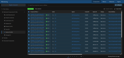

Hello @DerekLaw ! Good day
The issue persists for me on version 2024.1.1. Is there anything I might be missing?

Hi @HarunJoeVellikkara,
Can you please tell me which panel is being shown in your screenshot? I'm unable to tell which page your screenshot is showing.
To configure alert rules for the same metric for multiple components of the same type in Monitor: under the Administration page > Metrics subtab > select a metric in the table, then click Edit defaults
This is discussed in this blog, ArcGIS Monitor: Understanding Component Status and Alerts.
