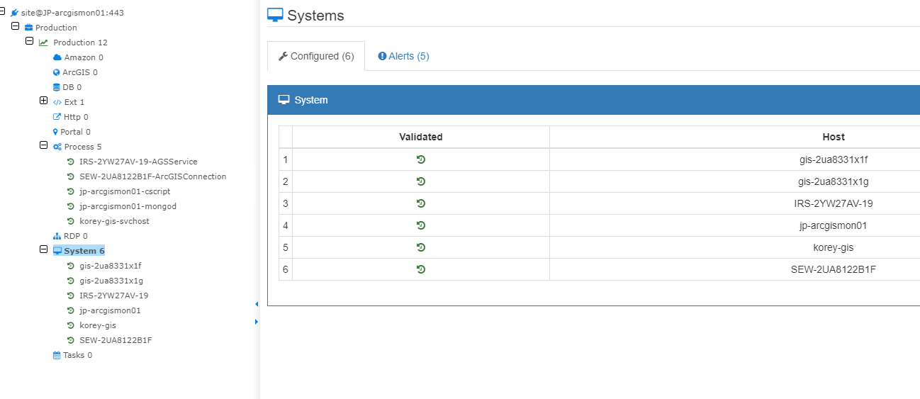

Hey, I am looking for some assistance with a problem I am having with Monitor 10.7.  I have a few old servers that I have removed from monitoring and no longer show up on the monitor administrator. Yet these same 'Ghost' machines still show up when you view the monitor site.  I've stopped and started the services, reset the performance counters. Yet I cannot remove these 'ghosts'
Below are the machine being monitored from the monitor administrator.

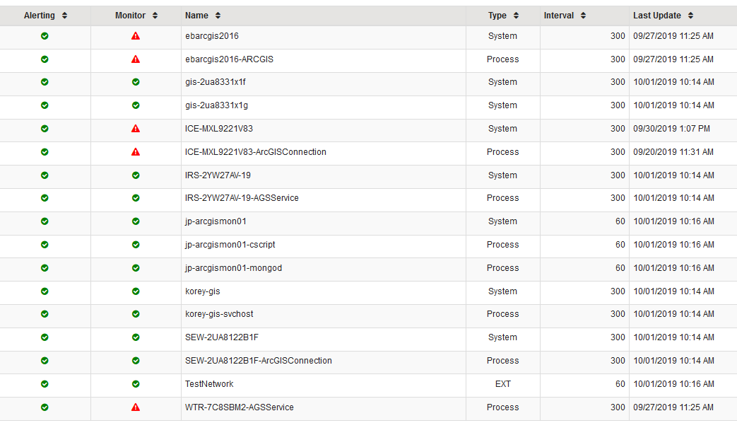

and here are the machines that are still showing up in the monitor.
Any ideas on how to rid my monitor of these machines would be most helpful.

Hey Rayburn,
Have you tried using the "Clean Views' function from ArcGIS Monitor Administrator?
Clean views—ArcGIS Monitor Administrator | ArcGIS Enterprise

RayburnClipper
Looks like that is what I needed, the items that were removed are now gone, and the 'good' items are filling in as data is collected.
