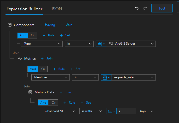

ChrisWoodward
Is there a way to aggregate the request rate metric for non-system services (only map/feature services) across the entire ArcServer deployment?
DerekLaw
Esri Esteemed Contributor
Hi @ChrisWoodward,
Yes, this should be possible. Please refer to this blog for some guidance,
5 Useful ArcGIS Server Analysis Elements in ArcGIS Monitor
In the first example for Requests Received Per Service, you can change the Identifier to be Request Rate.
