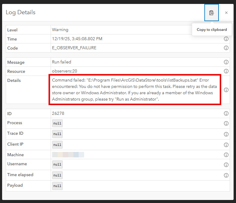

JannesCruiming
Hi @Craig_Lunde,
I just encountered the same issue as you reported here. We just installed ArcGIS Monitor 2025.0.1 to monitor an ArcGIS Enterprise 11.5 environment. The ArcGIS Monitor Agent is installed on the datastore machine and metrics for the VM are being gathered. However, the observers for ArcGIS DataStore (Inventory and Metrics) both reported No Data as status. The logging keeps reporting the same message:
So, I checked the permissions for the account running the Monitor Agent on the datastore machine. It has full control on the DataStore folder and subfolders (‪E:\Program Files\ArcGIS\DataStore). Then I added the account to the administrators group on the datastore machine and restarted the Windows Service for ArcGIS Monitor Agent. This has resolved my issue with ArcGIS DataStore observers not gathering data. Hopefully this will help you resolve your issue.
