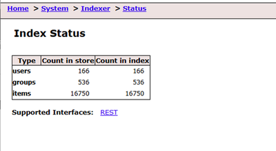

Hello - after registering 11.4 Portal with 2024.1 Monitor, my portal item counts are now showing 10,000 instead of 665.  My group count is showing 500, it should be 42.

I get it now.  If I go into portal admin and view the index status I see the high group and item counts.  Then when when I view the sharing directory from the Portal content directory I can then see all of the items and groups that are owned by esri_en, arcgis, etc etc. that come with portal.
It just threw me that the counts as reported by Monitor 2023.3.1 were so much lower....

Sure, well when I go into my Portal admin Index and view the index status, this is what shows:
Then the Portal component shows that I have
Users: 116
Groups: 529
Items: 10,000
The only count that the portal component has correct is my 116 users
So I thought when I saw the index counts so high in the Index Status I went to the Portal Content:
....gis05.ourorg.net:7443/arcgis/sharing/rest/community/groups?q=esri
and do a group search, in this case on "esri"
that comes back with 350 groups that have 'esri' somewhere in the group name or descript or summary or owner. If I do 'arcgis', I get an additional 260 groups.  So to me anyway it seems clear that the default is just showing totals of everything that comes into portal as a content type
