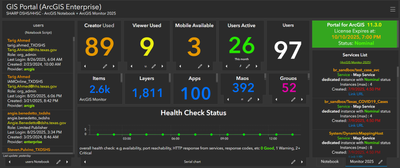

TarigAhmedTXHSDS
For now, I will just live with a Dashboard view.
DerekLaw
Esri Esteemed Contributor
That's a gorgeous ArcGIS Dashboard @TarigAhmedTXHSDS  - thanks for sharing!!
