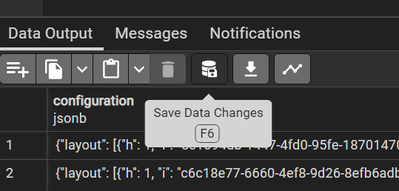

  5. Edit Analysis table as follows
    1. View/Edid Data using PG Admin
    1. Navigate to your analysis name row, e.g. “Prod”
    2. Replace the content of the configuration cell with the attached json file
    3. Save

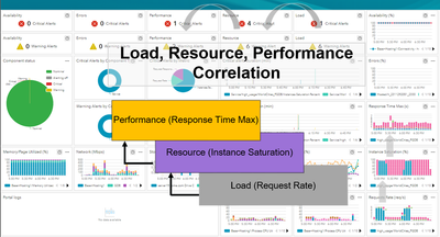

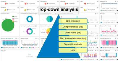

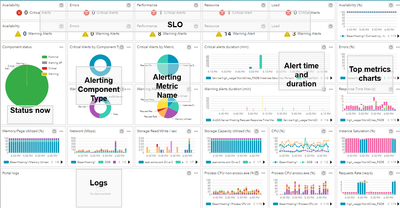

AndrewSakowicz
Please see below.

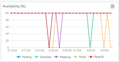

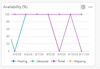

Question: We have a High Availability GIS System in AWS. What is the downtime mean in the screenshot below? is it the load balancer?
