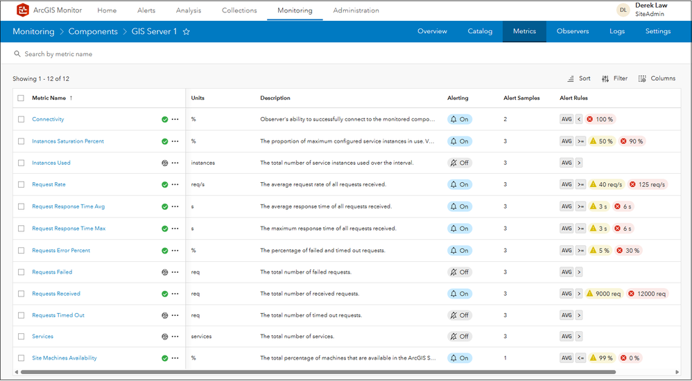

Here's a screenshot showing all the ArcGIS Server component metrics,
FYI, the information can also be found in the Monitor help documentation,
ArcGIS Server metrics
