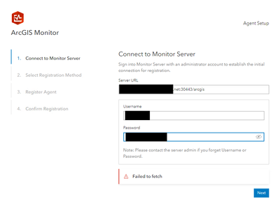

After upgrading ArcGIS Monitor to 2023.3.1 I am trying to add a new server. After installing ArcGIS Monitor Agent and trying to connect to Monitor Server I get 'Failed to fetch' on the first page. See below:
I have not been able to find any information on this error.

From the information you've provided, this sounds like a network configuration issue. Can you please verify that communication is allowed through the ports mentioned in this documentation?
Josh
Pat_Gallagher
I looked and 30443 is active. I had no issue adding new servers when running 2023.2 on the servers.

I got past the "Failed to Fetch" problem by opening up another tab in my browser and connecting to the monitor server as admin.
I then went back to the agent setup tab and clicked the Next button and it connected without complaint.
