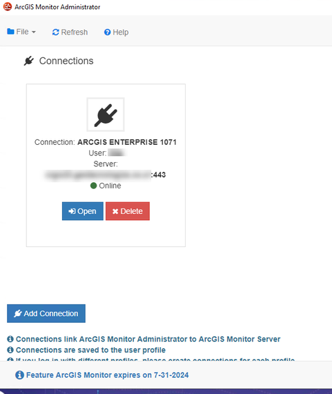

It would be good if ArcGIS Monitor could have the option to be installed with ArcGIS Web Adapter in front, so you don't have to access Monitor on port 30443.
Many organisations will not allow non-standard ports (e.g., 30443) to be open and only allow HTTPS 443 and RDP 3389.
Having the ability to configure the ArcGIS Web Adapter in front of Monitor would enable access on HTTPS 443 like other ArcGIS Server components and be compliant with organisation security policies.
