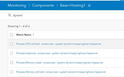

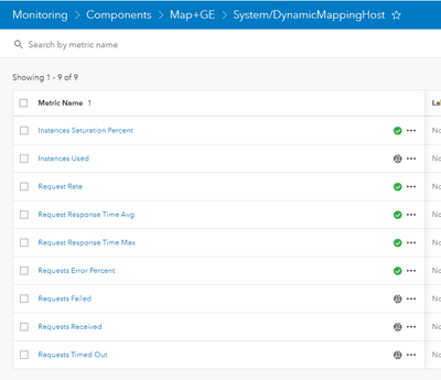

@BrettFrahm , thanks for sharing your idea.  Please note that many of the requirements you identified might be already available in the following:
Host>Process
Service System/DynamicMappingHost
