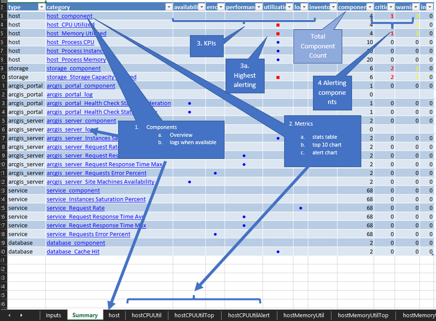

Overview
 Excel Report for ArcGIS Monitor provides information about
  1. Components

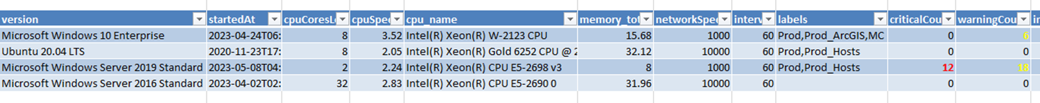

    1. Overview table (e.g., see below host _components)

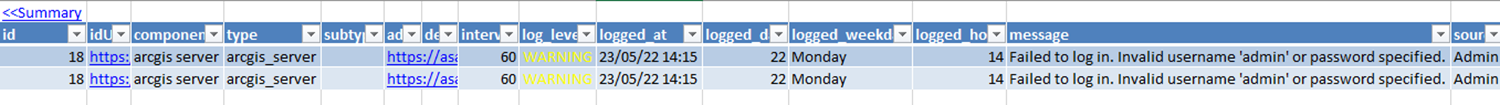

    2. logs for ArcGIS Portal and Server (e.g., see below arcgis_server_log)
  2. Metrics

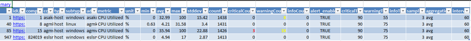

    1. Statistics table for a selected metric name (e.g., see below host_CPU_Utilized)

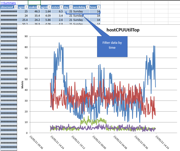

    2. Top 10 components chart (there is no hyperlink.  It is assumed users will click the above statistics worksheet and navigate to the left worksheet)

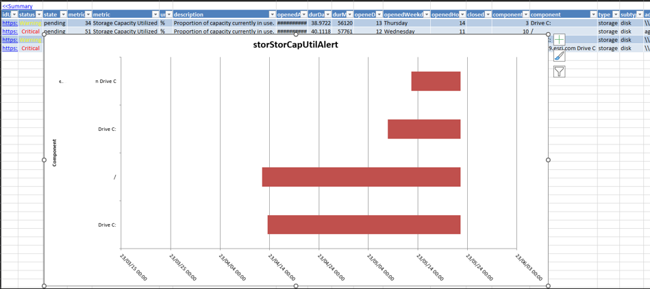

    3. Alerts chart (there is no hyperlink.  It is assumed users will click the above statistics worksheet and navigate to the left worksheet)
  3. Key Performance Indicators
    1. highest alerting status
  4. Alerting components
Component overview
ArcGIS Server Log
Metric statistics
Top 10 components
Alerting components
