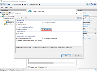

In IIS, a URL rewrite rule may be configured to forward traffic from IIS to ArcGIS Monitor.
1. Click Start and type inetmgr to open the IIS manager
2. Choose the Default Web Site, then Add Rules
3. Choose  Reverse Proxy to open the rules dialog

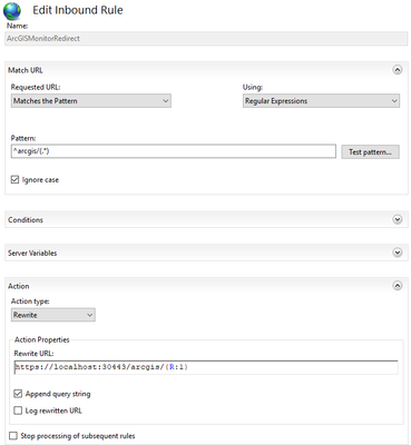

4. Under Inbound Rules, define the address and port to which incoming requests should be forwarded.
In the case below, the target ArcGIS Monitor Server resides on the same machine as IIS, so localhost will work. However, if they are separated, use the FQDN of the ArcGIS Monitor Server machine.
Port 30080 may be used for both HTTP and HTTPS as long as Enable SSL Offloading is checked (this ultimately assumes HTTPS is configured at IIS and with a certificate) and will encrypt traffic from the user to IIS using its certificate.

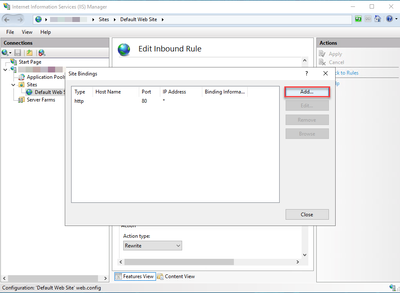

Enable HTTPS
When choosing to offload SSL at IIS, HTTPS should be enabled along with a trusted certificate.
1. Choose the Default Web Site, then Bindings... to open Site Bindings dialog
2. Choose Add to add a new Site Binding
3. Select Type as https and choose the relevant SSL certificate available to IIS. A certificate may need to be provisioned if needed.

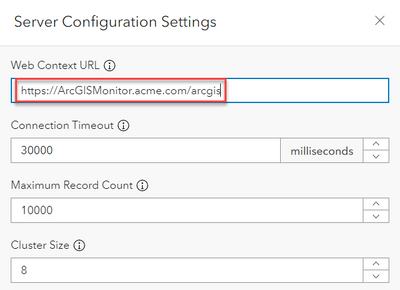

Update ArcGIS Monitor Web Context URL
The ensure proper URL generation for all workflows, update the ArcGIS Monitor Web Context URL to match the new path through IIS:
1. As an administrator, log into ArcGIS Monitor
2. Navigate to Administration
3. Under Server > Server Configuration Settings, choose EditEvanMosby_0-1690231110229.png
4. Update the Web Context URL to match the new path through IIS
5. Restart ArcGIS Monitor for the changes to take effect

After the above configuration I had: HTTP Error 502.3 - Bad Gateway
I changed the rule:
Pattern = ^arcgis/(.*)
Rewrite URL= https://localhost:30443/arcgis/{R:1}
in C:\inetpub\wwwroot I added the \arcgis directory
and added a redirection to Web Context URL in DefaulfSite to increase IIS security (I have just site "arcgis" on IIS)
Now the redirect work as expected.

  5. Set Up URL Rewrite for Reverse Proxy
    • Select the Default Site.
    • Open URL Rewrite Module.
    • Click on Add Rule(s)… in the right panel.
    • Choose Blank Rule and click OK.
  6. Configure the Rule:
    • Name: Set a name, like ProxyToMonitor.
    • Set Requested URL to Matches the Pattern.
    • Set Using to Regular Expressions.
    • In the Pattern field, enter ^arcgis(/.*)?$. This pattern matches /arcgis and anything following it.
    • Set Action Type to Rewrite.
    • In Rewrite URL, enter https://machineB.domain.com:30443/arcgis{R:1}.
    • Set Append Query String to True to forward any query parameters from the original request.
  7. Click Apply on the right side to save the rule.
  8. Set  WebContext URL on ArcGIS Monitor Admin Window "https://machineA.domain.com/arcgis/"
  9. Go to https://machineA.domain.com/arcgis/ in a browser, and IIS should now proxy requests to https://machineB.domain.com:30443/arcgis transparently.
